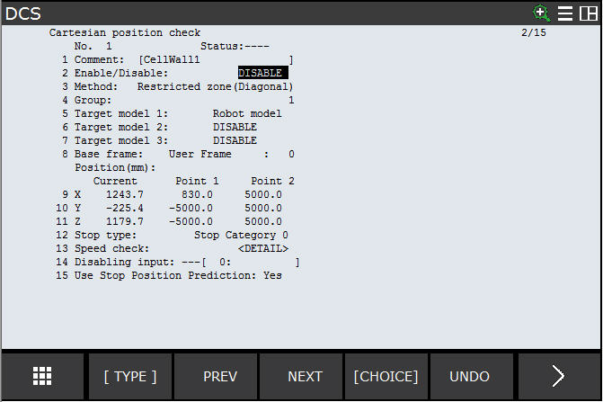

- SELECT –> [ 7 ] 7 DCS (see screenshot)
- Using arrow, SELECT –> 1 of the 4 first option (see screenshot)
- PRESS –> [ F3 ] [ DETAIL ]
- PRESS –> [ F3 ] [ DETAIL ] (see screenshot)
- Using arrow, SELECT –> Line 2 Enable/Disable (see screenshot)
- PRESS -> [ F4 ] [ CHOICE ]
- SELECT –> [ 1 OR 2 ] 1 DISABLE 2 ENABLE
