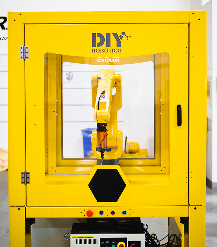

The New Robotic Deburring Cell
DIY-Robotics brings you cutting-edge deburring technology with our new Robotic Deburring Cell. Our newest product bundles a high-caliber FANUC robot with an ATI-compliant deburring tool. The programming is simple, intuitive, and powerful thanks to innovative software from RoboDK.
